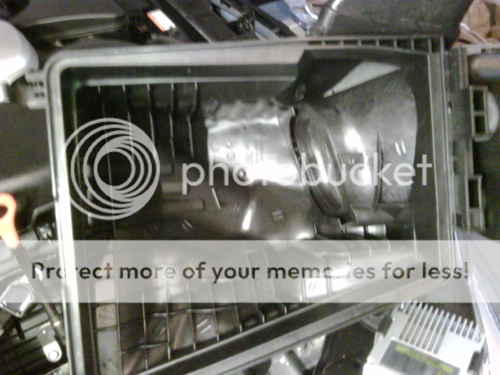

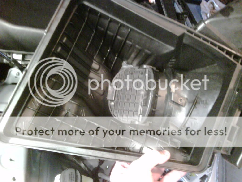

One thing I noticed, and took pictures of, was the magnetic flap inside the airbox that opens to allow more air under full throttle. It's mechanically actuated via a magnet that hold it closed until the vacuum inside the airbox is great enough to pull it open. I decided to take it out, removing that restriction. Power Gains? Honestly, I doubt it, but I also have not driven the car hard enough to tell or dyno'd it to really tell. Theoretically, it seems like it would help a little with restriction though, so we'll see.

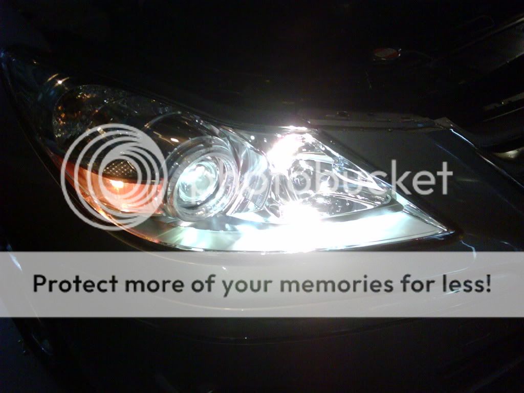

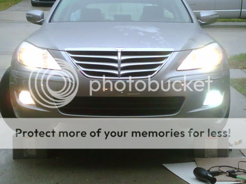

I am having a problem with the conversion kit for the fogs. The passenger side will not ignite, but for a split second. I'm assuming it's an issue a "resistor kit" will fix, so I have one ordered and on the way. I did get them both to work for a short time and they look awesome, when compared to the stock halogen bulbs. Luckily, the lenses for the fogs doesn't create a "blinbing" effect for on coming traffic. (I had my neighbor take the car out and we did a little testing, while both fogs were working) The high beams however, are a lot brighter, once the Xenon bulbs warm up...What a dramatic improvement over stock.....

Stock halogen high beam:
Xenon Conversion in the high beam:
Stock color lowbeams (these will be changed out to 6000k D1S bulbs, so they all match, on Monday) with the dirver's side fog in Xenon and the passenger side fog stock halogen:
This is the airbox before and after, plus a picture of the engine bay with the airbox out of the car:

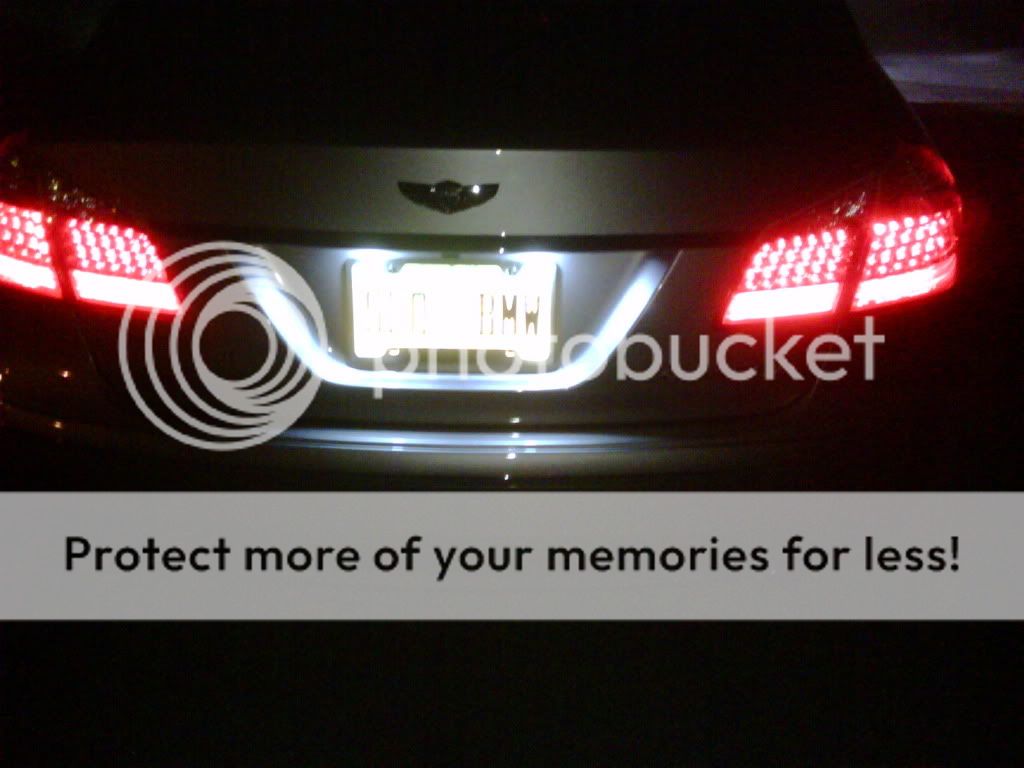

i swapped out the license plate lights tonight. put in the LED bulbs and they look awesome.
I'll take a pic tomorrow when i pull the car out of the garage to go to work.

again, this picture probably doesn't do it any justice:

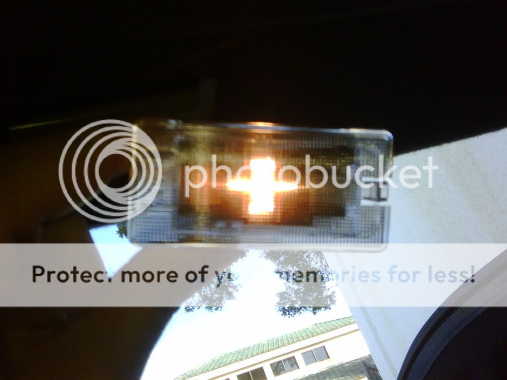

Just did one of my trunk lights, using the same 38mm 12 LED bulb as I did for the license plate lights.
Here's some camera phone pics of the differences. Yes, I had to bend the connectors to get the 38mm bulb to fit, but it was an easy task.
Stock Bulb:
LED:

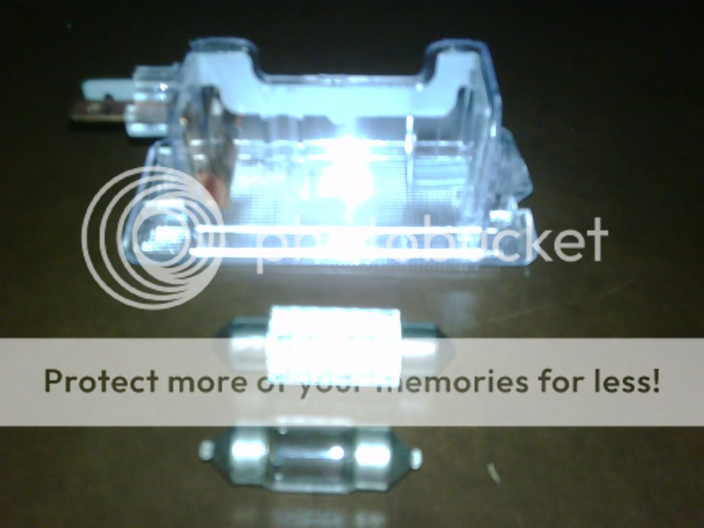

No Problem....Here's a quick pic of the bulbs side by side. You can also see how much I had to bend the contacts to get it in, but like I said, with a pair of needle nose pliers, it was a breeze. Just remember that you will need to bend back the tip of the brass part, so the black cover will slide back over the bulb.
There's also a (+) and (-) side, so be sure to test the bulb before putting the black cover back on and re-installing the housing.

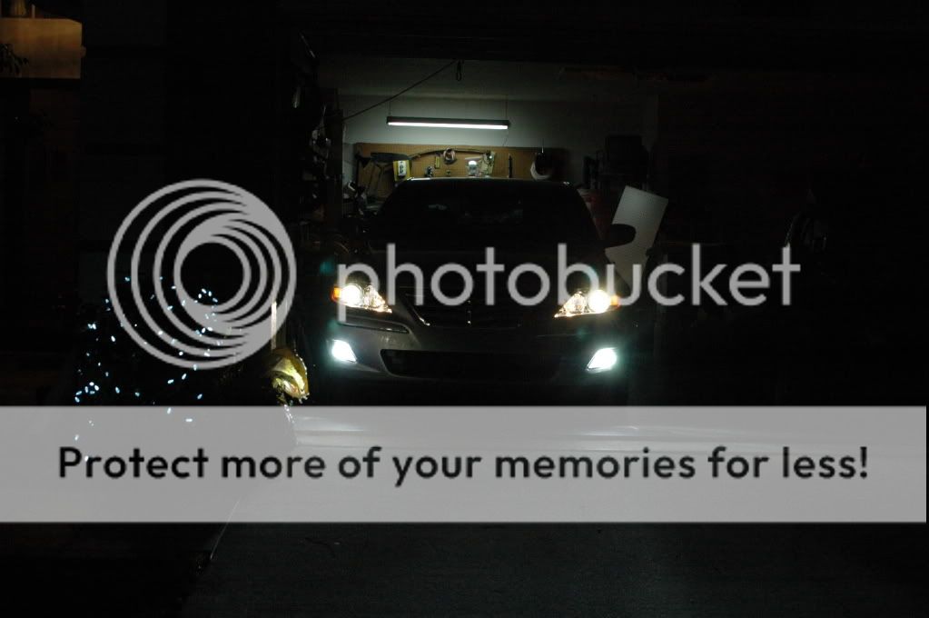

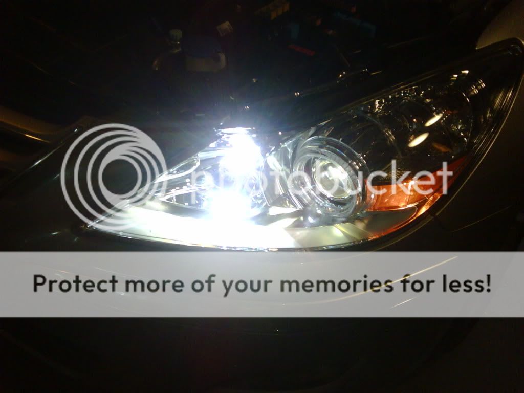

another picture with the xenon conversion in the fogs:
the headlights (6000k) should be in by Wednesday, so all the lights will match color
