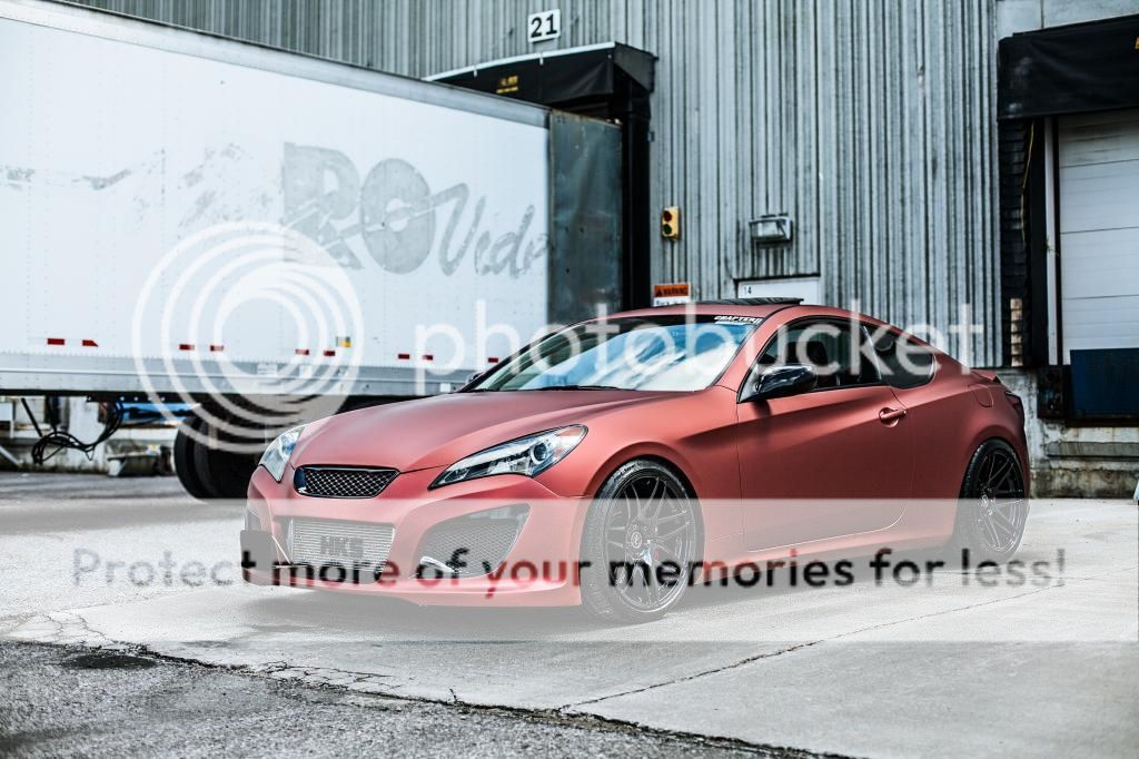

I've had my genesis coupe vinyl'd up here in Canada over the last couple of years and it sounds like the shop you did it at does not know proper vinyl installs. With the weather you have in Florida you should have less problems that us here in Toronto since heat is a good thing when installing the vinyl
Did the shop clean the area that the vinyl was installed? A good shop will clay bar the car to remove any sediment that will impact the install and smoothness of the material. The fact that they said they can't do mirrors is lazy IMO.
Wrinkles need to be redone. Small bubbles may appear but disappear after a day or two when left in the sun.
Here is the first wrap job done on the car. Matte Red Aluminum.
