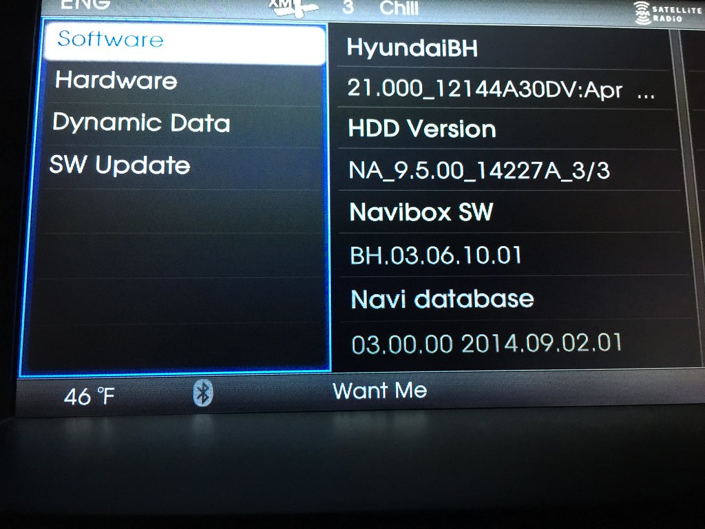

Updated the following from JP Auto Sound. Cost $250.00 for everything. Dealer wanted $320.00 for the map update.
UTA (Amp) 10.20.50 (7.4i)
SDS (Bluetooth) (8.20.2)
Head Unit (21.000)
Navibox SW + Navi Database (9.5.00) + 2014 Maps
Versions from before:

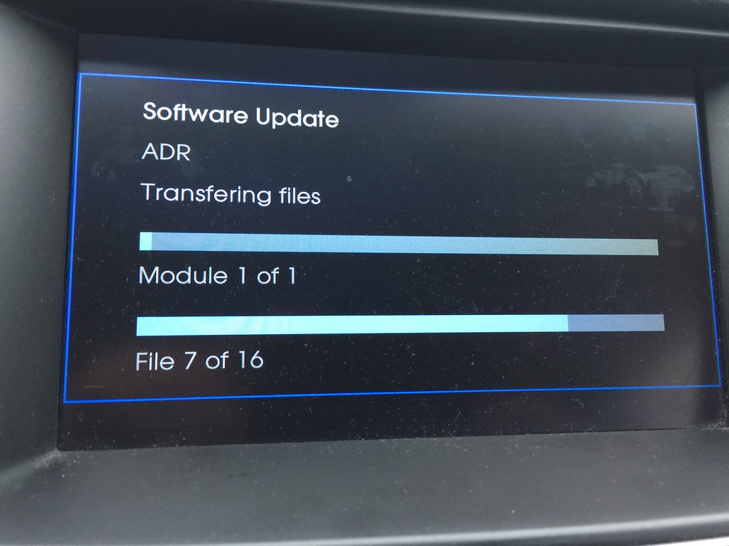

Software Update Process:
Current Version:
Also FYI, those from this thread TSB 12-BE-012 killed my NAV
The symptom of No Navibox SW and No Navibox Database (pictured below) is the result of either a short (less common) or the lack of map updates installed.
****Maps have to be installed after the update. Otherwise, you will get the dreaded navigation is starting forever.

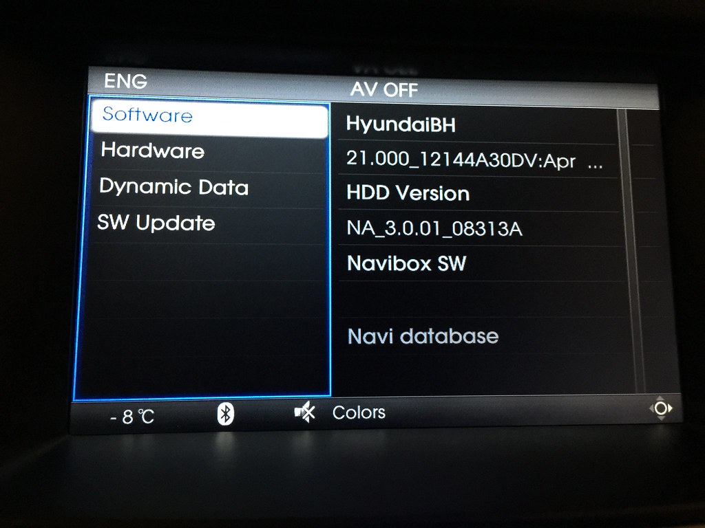

I finally opened up the engineering info.
I attached a picture. Is this the right info that you need?
Thanks!
That is the original firmware (which is pretty old), I take it you do not have XM subscription?
