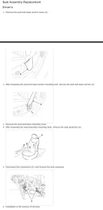

Seat removal procedure:

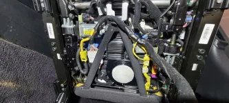

Thank you for this info! I have gone through just about everything now. Filter under the peltier looked good, I air dusted the fan blades to make sure but seemed very clean. Checked to make sure it was sucking air through the vents and it was.
Cleaned/steamed the leather seats to make sure the perforations weren't blocked, although they seemed clean already.

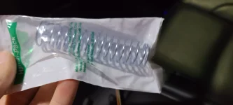

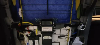

Then, I took the seat back off (the trickiest part) and checked the hoses which all seemed fine. I took 3 3/4"x3" springs and made an "H" around the inside foam air inlet as per Hyundai's recommendation. It seemed like the foam was blocking off air flow and even the lumbar airbag (which I could not get to deflate) was putting pressure on it. The springs, in theory, should help.
One though I had, my air conditioning is not super cold. This could affect the seat cooling since the air being brought through the peltier isn't very cold right? I should address this. Also, the tops of the hoses (where the insert into the seat from the peltier) have an outlet. I can feel air being blown out the top of it like a relief valve of sorts. Seems like odd design and I can't help but wonder how much this lowers the pressure of the air blowing through the seats.
