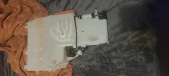

I have a 2016 g80 sedan. How to replace my original windshield washer bottle? It has more connections on the inside of the bottle then the replacement I have but I don't know how to make it work. The picture are of the old one with the (gray and peach background cloudy looking) and new one.

Did something chew the wiring in two? Looks like the new one doesn't include the washer pump?

The parts look the same except that your old washer unit is missing a connector(cut or broken off). I would try to find the missing connector and hopefully the other matching connector that is attached to the main harness is still attached to the harness; so that you can plug it into the new washer.
