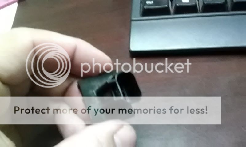

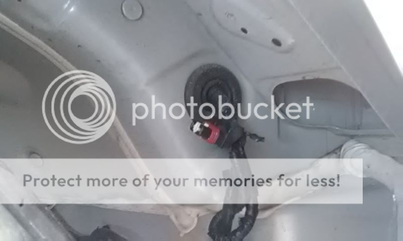

I am repairing a Genesis Sedan, 2013 model. In the drivers fenderwell, behind the liner, there is a wiring harness that plugs into some sort of module. It it in the 2 o'clock region of the wheelhouse. I have a couple of pictures. We have been working with our Hyundai Distributor- but they seem as lost as we are. It doesn't seem to be causing any issues with the car though. We was told it might be the TPMS Antennae, but it wasn't. Then some keyless entry horn, nope(this is in the front of the wheelhouse). I am whooped on this. So I thought maybe you guys might know.
A couple of pics...
Harness Area-
Broken part (well what was left of it)-
Thanks in avdance- really want to get my customer some peace of mind.
I think it's for the keyless entry external buzzer.

Thank you so much. appears I do have the correct part. We didn't think they would have 2 buzzer/horns. Thanks!
