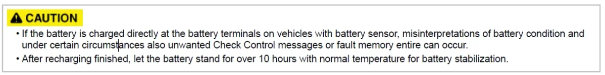

Do not charge the battery directly at the terminals. If you have to, then use the chassis as -ve. There is a warning in the service manual regarding this:
