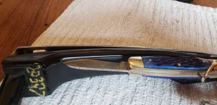

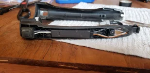

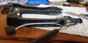

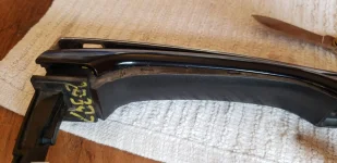

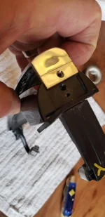

I had the same issue, but I was able to remove the handle and take it apart so I only had to replace the button. Since the same button works for both passenger and driver side, I ordered a used passenger handle on ebay as I figured it would have more life left in it and transferred the button piece to my driver door handle. I'm still using the original handle so the color still matches the car. The handle can be easily removed by opening the door, removing the black plug on inside door and using an 8MM socket to remove the bolt holding the lock in place. Be careful not to drop the bolt. I used needle nosed pliers with two hands and constant pressure to remove the bolt once it was loosened with a ratchet. Once the handle is removed you'll see there is a phillips head and 2 torx screws holding the handle pieces together. The phillips and a torx screw are visible from the outside. The second torx screw is on the same side as the first one, but underneath the chrome trim piece. Once you've removed the screw holding the chrome trim on, slide the chrome trim piece up to reveal the 2nd torx screw. Remove that and the handle is ready to be taken apart. You don't need to completely remove the chrome trim piece. I've attached pics on how to take the handle apart. the Top piece is held on by the screws you removed and tabs. A sharp knife will separate the pieces, just be patient and wiggle the knife a bit until you here the pieces unsnap. After that it comes apart and the button is exposed. Remove the button, replace the same way with the new button and re-assemble in the same order as you disassembled.
