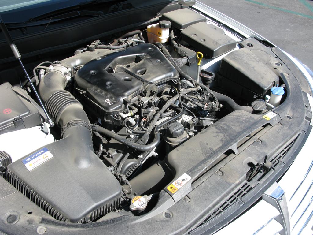

Is this what the V6 looks like under the engine cover?
If so, it should be very similar. From the looks of it, you should be able to pop the tabs on the air box cover, the same type of clamp holing the intake tube to the air box cover, and remove just the cover.
From there some pliers for that hose clamp on the small hose at the end of the intake tube, slide it down the hose, the hose should wiggle free from the intake tube.
It looks like there is no MAF anywhere on the intake tube itself, so it should just be another hose clamp with a 10MM screw on the end of the intake tube where it attaches to the throttle body.
I definitely think it would be an easy job to remove that stuff, and I don't even think the bottom half of the air box would need to come out at all.
Yep, that's the v6 basically. I'm going to work on getting some video or close up pics this weekend. Stay tuned!
