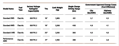

This might provide some idea of what to expect. It suggests going from 20 to 19 provides ~5% more range. Obviously wheel weight is what drives savings, so a few variables to consider
