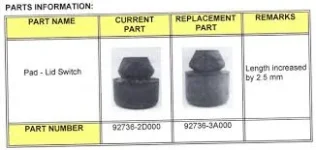

Presuming your issue is battery drain, not a "dead car"...
There's a little rubber bumper under the hood for the contact switch that triggers the security system. If it falls off it will keep the security circuit alive and kill the battery in a couple days.
There was a TSB on it ... had it done on my '09 after this exact thing got me stuck at the airport.
Some useful pics:
Some useful pics:
View attachment 23823View attachment 23824

-and I think the rubber stop is too short.

- is it common for the switch That this rubber stopper engages with to be bad? Would that be the cause?

the rubber bump stop is adjustable, turn it to make it longer or shorter.

I just saw there was no rubber stopper at all, so I’m assuming that’s the issue. I’ll order a part. But will I need to replace the battery, or will it be okay once I charge it? If all it needs is a charge how long should I leave it hooked up?

The alarm will confirm arming on double-press with the fob lock button (light flash, horn honk or beep). If it doesn't then one of the door sensors or hood sensor is showing ajarr. Your hood alarm button seems to be the correct one and sensor looks to be in the correct spot (you can test it by dusting the stopper with a bit talc or powdered makeup to see if and where it contacts the switch). Yes I do see very clean paint and plastics and several missing fasteners so the front end may indeed have been reconstructed, or someone took a LOT of time cleaning up that engine bay to be as clean as or cleaner than factory new. My '09 and '12 never looked that good and my prize winning show car Camaro doesn't either :ROFLMAO:
