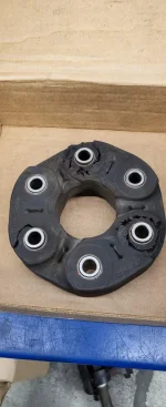

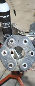

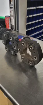

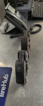

CONFIRM! I went and got the dorman 935-107 for my Genesis sedan rspec and worked out perfect for the front and the rear. brand new couplers make a huge difference car over all feels so much smoother during specially during shifts and hard acceleration.
Good deal. Did the bolts have reverse thread on them?
