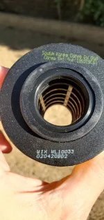

I've compared all filters available for the 2019 3.8 engine and decided on the WIX. It's a quality, well made filter. The OEM filter is made of paper so not sure a buyer can do worse. There are a few name brands to choose from. I have attached photos of the WIX that I install on mine. They come with the gasket and washer.
Check out filters available on RockAuto.
