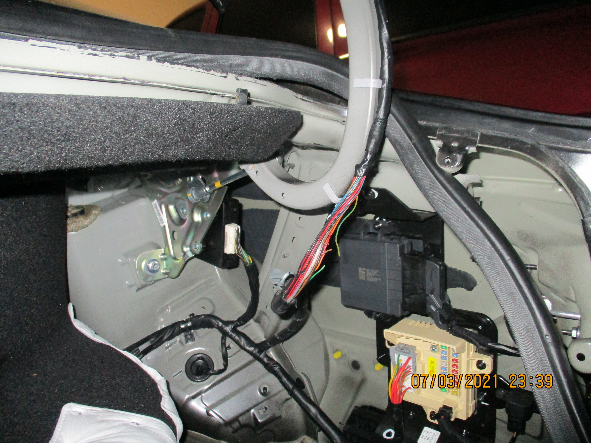

I have the same problem, I assumed it was the actual light, but it not . I Ohmed out the circuit and I found out I was missing a ground. Broken wires
My original repair of just running a jumper wire from the left brake wire to the right only lasted a while. Since as others above revealed that the wiring harness gets repeatedly bent and breaks wire after wire. So the right trunk brake light and running light quit working. I took it all apart as described above, I had 4 cut wires and 4 that were just about cut through. I soldered on wire extensions so they had more freedom. All the lights work now. Thanks everyone for the tip!

Well, it was the left side. Ground was broken for the actuator and a power was broken for the reverse light. Interestingly the ground had been repaired before and broke right at the old butt connector.
Photos for those who come after.View attachment 53775View attachment 53777
Yeah, you can't just splice the wires back together and expect that to work. You have to cut out a few inches of wire on each side and then splice in a new piece of wire a little bit longer than the wire that you cut out on both sides. Solder and heatshrink would be better than the crimp barrels.

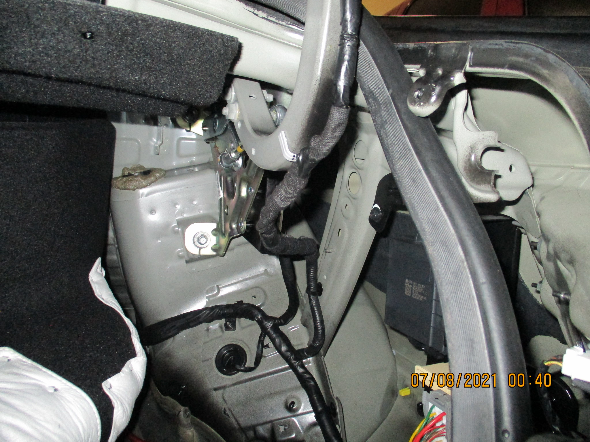

Here is how I rerouted my taillight wiring harness after I repaired the broken wires just as described in the TSB. I have no issue opening and closing my trunk.
Old wiring harness location with bracket and broken wires
New location after the repair with bracket removed.
