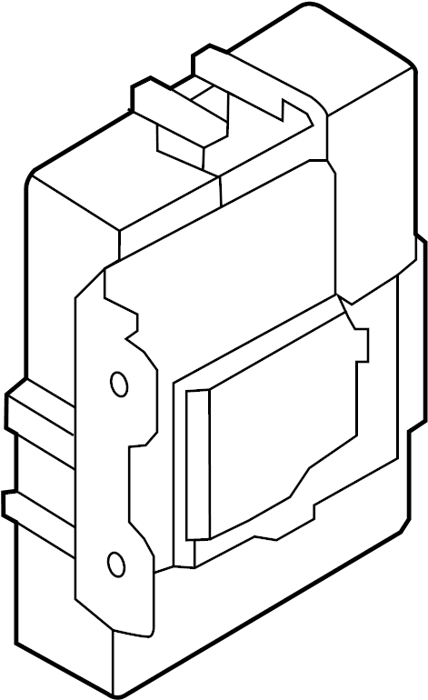

Park Assist Control Module
Part Number: 95770B1100

Park Assist Control Module​
Supersession(s): 95770-B1100
View 95770B1100 Park Assist Control Module Full-Sized Product Image
View Park Assist Control Module Full-Sized Product Image 1 of 4
View Park Assist Control Module Full-Sized Product Image 2 of 4
View Park Assist Control Module Full-Sized Product Image 3 of 4
View Park Assist Control Module Full-Sized Product Image 4 of 4
Module. Control. Unit. Assembly - Parking Guide System. Park Assist.
A microprocessor Controlled Unit which manages the functions of the Park Assist System. Backup Camera. Camera System. Park System.
BACKUP CAMERA. CAMERA SYSTEM. G80. Genesis Sedan. PARK SYSTEM.
