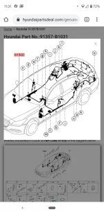

I had similar problem, recurred over a number of years, along with other electrical gremlins. Latest fix is replacement of a wiring harness that required removal of the interior and dash. It’s a big job and the harness alone is $3-4K part. Took about 60 days in the shop and they f*cked up some stuff putting it back together.
Seems to have solved the problem
Good luck.
Here is the harness, well wiring assembly
They actually just replaced all these harnesses in the latest repair attempt. It has been back at the dealer for nearly a month now but I will supposedly be getting it back at some point next week after they spend a few days attempting to confirm that the issue does not reoccur. Hopefully it takes care of the issue as it did for you, but I will follow up with what happens in case it is helpful to anyone else.
