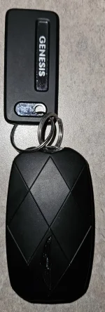

It appears that the mechanical keys for 2023 are not in the smart key. They are provided separately. The OP's are probably still in the glove box.
I have a 2023G 90 and just went to the dealership and he showed me how to get the mechanical key out of the fob. It’s a little difficult. You need a small screwdriver, but it is inside the fob the key you’re referring to inside the glove compartment is the valet key and locks your glove box. You cannot use that to get into your car if your fob is dead.
Good to know.
That's strange as my 2023 G90 came with a mechanical key that is separate from the FOB. I tested it on my driver's side door and it will open the door. There is a little plate that you can access by pushing the front of the door handle in to pop out the rear part of the handle and the key can be inserted to unlock the door. Does your FOB look like the one below? Here is a picture of my mechanical key. It is in the rectangular case on my key ring. I am not aware of anything inside the FOB. Can you send a photo?

Your experience agrees with the owner's manual.
Sorry for resurrecting this from the dead, but wanted to correct the record or find out what I am missing? I was trying to determine what the corner button was for, and it lead me down this rabbit hole.
There is no key inside the 2023 G90 E-SC key fob. You can remove the lanyard connector, by pushing the silver springy button on the corner of the fob. After that is removed, you stick a flat screwdriver into the fob and twist. Screwdriver should fit in the slot, which is about a 1/4 inch wide. That will expose the coin battery for the fob, but there is no slide rail for the mechanical key that is pictured in another post above.
