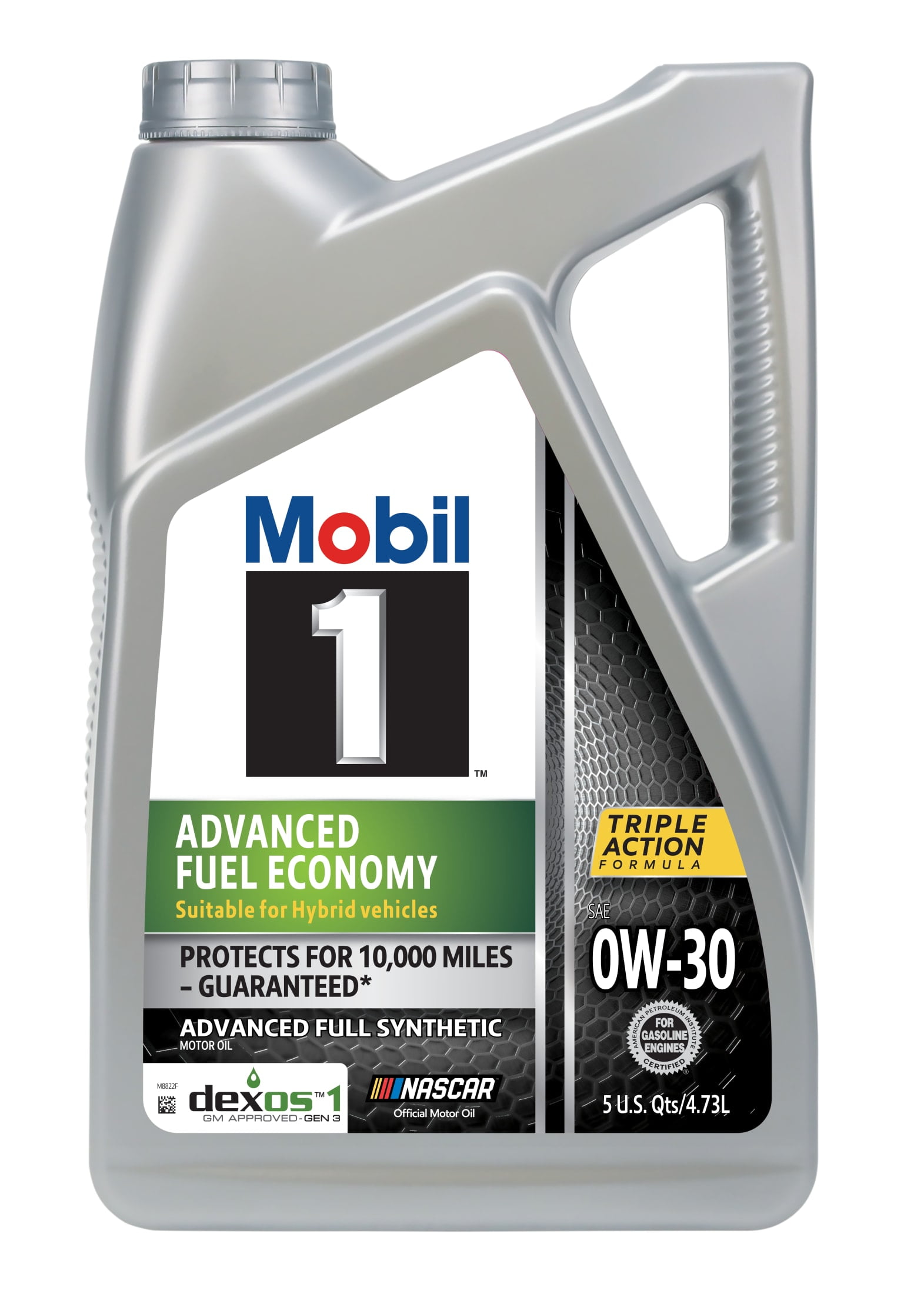

BTW, I've not yet seen a 0w-30 synthetic product from Quaker.
Best price on 0w-30 is linked below:
