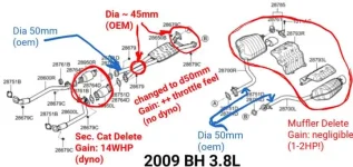

pipes are 2" .. except at sime sections they are necked.
Sec cat delete on all stock exhaust is a simple & great performance gainer. Yet has no noticable effect of sound, may be a tid louder at high revs.
Rear mufflers swap to straight through ones .. gives a louder exhaust note, but has some cabine drone, with no serious gain un performance.
Stock mid pipe resonator is prrallel 2 x straight through 2" bore .. I don't think deleting will add any performance gain. while sure will change exhaust sound. (I kept it)
Mid pipe section has those marked bottle necks where pioe cross-section is reduced. Replcing these sections with 2" clearly felt enhanced performance (no measure data), even with stock resonator.

Thanks for the reply, so far i've done an xpipe in place of the stock res and removed the bottleneck at the same time which gave a lil bit of a difference in sound but isn't noticable inside, though where it made a noticable difference was it added some snaps and crackles when you rev it or when you let off after a pull.
So my next change is probs a set of straight through mufflers to replace the stock ones and maybe delete the 2nd set of cats if i still want more noise after that
