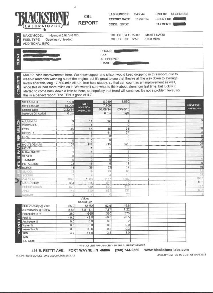

I dumped the OEM oil at about 1800 miles for 5w-30 Mobil 1. Then changed again at about 7500 miles. Now the 3rd change at 15,000 miles. Results look good and could run the oil longer, but won't (warranty and my own caution).
Not sure where the iron is coming from as I thought the block was aluminum.
Does the 5.0 have separate cylinder liners or are they an integral part of the aluminum block?
As for the crankshaft and cams, they should be hardened and little little material coming off them.
Has anyone else gotten an oil analysis on a Hyundai engine?
