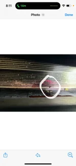

Did they send you a picture?

Same problem here they currently have my car (2023 gv70) 16k miles on it. said rock cracked the radiator here’s the photos they sent me
Doesn’t look like a rock to me but a straight cut
So I went out and looked at my intercooler radiator and it looks exactly like the one in the picture posted above. That little T in the middle is a joint between the two sides that hold the radiator fins. I do not have a leak and my coolant reservoir is full. So my question is where is the evidence of rock damage???
Look at the pink sludge at the top of where you circled. Clean all that off, and you will find where the rock punctured.
