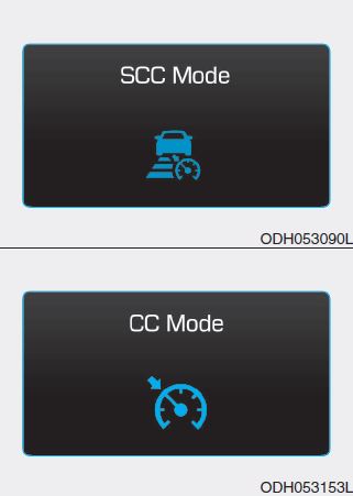

At least it's fairly easy to toggle back and forth between CC and SCC (press the cc button off and then on, hold distance button for 5 seconds.)

You do.
After you engage the cruise button (but not having set a speed) press and hold the smart-cruise distance-keeping button on the steering wheel for a few seconds. Dash screen will display "CC Mode" momentarily. You now have dumb cruise control.
Press and hold distance-keeping again (without an active, set speed) and you will see "SCC Mode" to return it to smart-cruise mode.
