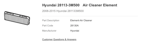

Note the use of plura as there are two air filters. The common most filter is the large flat filter in the airbox. This filter is used by all first generation Equus and Genesis - even the V6. Its part number is 28113-3M100. K&N makes a replacement for this filter.
The second filter is much smaller and yet very important. It fits just inside the top of the radiator, and provides a direct airflow into the intake manifold. It is unique to the Equus and all 5.0 liter Genesis. This filter is often overlooked by dealers doing routine service and may not be in stock. Its part number is 28113-3M500. K&N does not have a replacement/equivalent for this filter. This filter is "protected" by a removable flap that is designed to open only at wide open throttle. This flap is easily removed, but if you do so then change the filter more often.

I got a 2014 Equus. Previous owner said, "I had everything done at the dealer". I know then I had to look it over. See picture of dirty filter. The main engine air filter, the cabin filter were both clean. The owners manual calls this little filter the chamber filter. Had to order it at the dealer, see picture of the box. Replacing it is definitely DIY...

My manual refers to the second filter as the "chamber air cleaner".
I replaced mine with a Premium Guard #PA99255.
RockAuto has two different brand filter equivalents of the 28113-3M500, each less than $10.
HASTINGS / BALDWIN AF1611
WIX 49650
