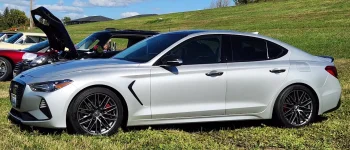

Alright. I jacked the car up and pulling the dust cover down was easy. Making it stay down required a couple of zip ties. I then used a razor and cut the bump stops 20mm or so... I found holding the razor still and rotating the bump stop worked. My hands cramped up several times because of the angles but overall pretty easy!
Thanks again to @Volfy for the suggestion. I hadn't thought of it at all. I went for a drive and hit the bump that usually causes the *thud* and sure enough, no noise!
..oh and I didn't do anything to the rears.. not sure if it's worth it but for the sake of consistency, I probably should..
(Don't mind it being caked in dust. I washed my car yesterday and went straight to a car show, where I wiped it down buttt the show was down a dirt road - ugh)
