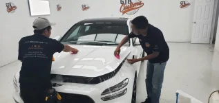

You want to PPF first (I recommend the front bumper, entire hood, entire side fenders, "B-pillars,", door cups, rear bumper ledge, and mirrors) and then apply ceramic coating afterward. I also recommend rustproofing/undercoating if you want to keep your car in the best condition or for long term protection (especially if you live in areas where snow and salt are prevalent). PPF the entire hood and side fenders so that the job is seamless, and more importantly you won't see lines that could show dust/dirt by only doing a partial PPF.
