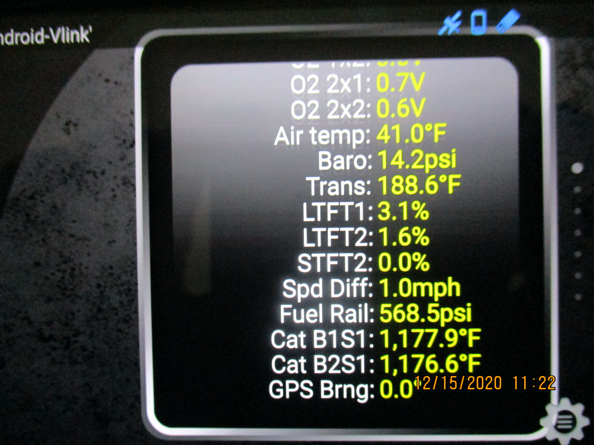

My 5.0 transmission temps hover around 190F(Torque Pro meter) after about an hour of driving; which is ideal to burn away moisture in the oil.
I am not sure why your transmission fluid runs that cool, but you may want to drain the fluid if the additives are keeping the fluid too cool as to not evaporate the water that may be inside the transmission fluid as transmission fluid is hydroscopic(attracts water from air).
Just my opinion based off of information I read online over the years about transmission fluid.
Here is an old reading on my 5.0 including the transmission fluid temp.
