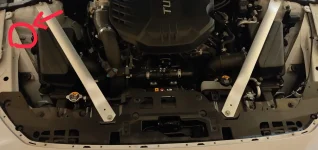

Where is the location of positive terminal under the hood for connection of battery maintainer or must it be connected directly to battery in trunk? I see the red + at rear of fuse box location but no readily identifiable connection point.
I wondered about this also. There is an exposed metal clip-like thing that appears to me to be the positive connection but it is so close to the rest of the fuse box items it is not a secure location.
The positive terminal is accessed when you pop open the fusebox located in the upper left corner of the engine bay. It has a red "+" sign on the cover. When you remove the cover, you'll see the metal prong sticking out that you can attach the positive connection.
The negative terminal is located just beside the passenger side airbox, it looks like a long bolt, attached to the body, and sticking out into the engine bay. There is actually a "-" sign stamped right next to it.
Circled in red...
OR, you can always just access the battery directly from the trunk if needed.
