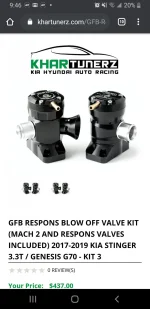

So from reading the article they pretty much talked about the humongous single bov they had.. the ones i was looking at from khartunerz are this.. pretty much oem replacement but metal body and slight adjustment between atmospheric and recirculating.

Are you going for just sound? An aftermarket intake will provide plenty of BOV noise. The only reason to change the BOV would be if you wanted to change that sound specifically
I just got a set of AEM intakes delivered today and will be installing this weekend, but i guess the bov would be for added protection and longevity of the turbos and also why not a bit of melody under the hood 😅😅
The aftermarket doesn’t provide any advantages over OEM. If you want to ‘protect and provide longevity’ stay stock in that department. All risk, little to no reward
Ohh ok a friend of mine talked to me about considering the aftermarket bov option but im glad i actually started this blog.. if there are no benefits then theres no need.. i could use that money for something alse.. thanks a lot
