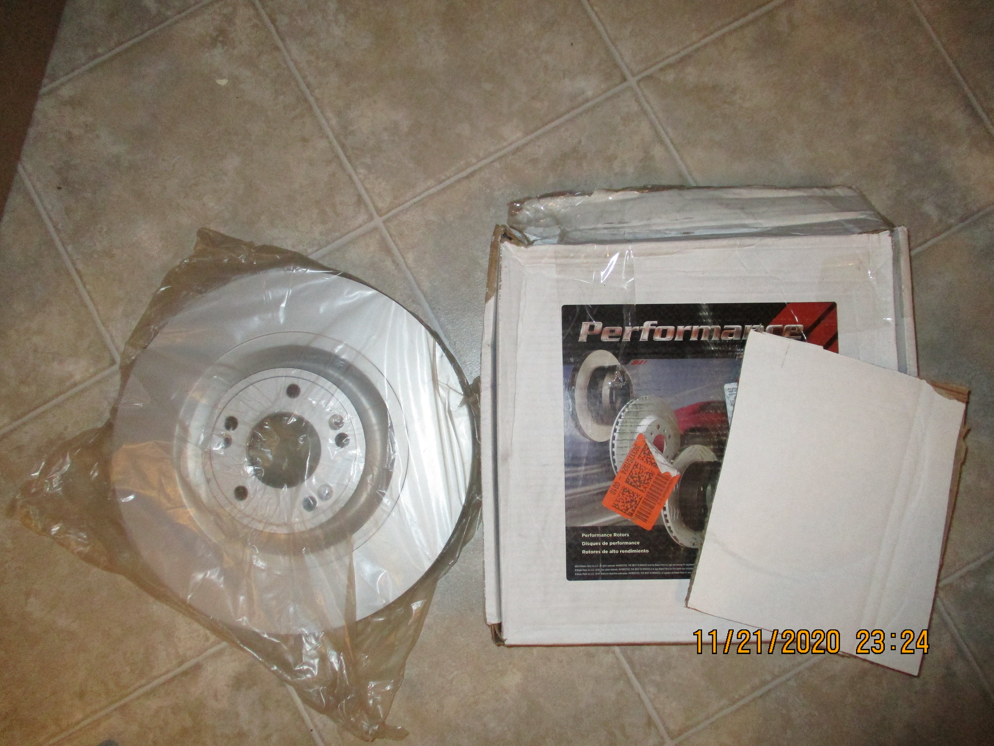

I will be installing Raybestos Street performance rotors. I got an open box Raybestos front rotor off Amazon for $22. I guess someone ordered the wrong size and returned it. The rotor looks perfect and was not used. The large Raybestos 14in rotor is usually $98 new on Amazon.
My $22 rotor!!! Amazon does have some good deals. However it was the only one available at the time. I will have to pay full price and wait a month for a second rotor.
I just ordered what had the best ratings for a 'bundle' on amazon....pad and rotor deal...
That "Performance" box looks kind of familiar. I did this about 2 months ago....sorry...

No problem. I will give some feedbak on the Raybestos top of the line performance pads and rotors. I usually just change all my pads and rotors at the same time as a habit.
To tell the truth, my old/original rotors were barely marked/didn't really need to be replaced....just 'tuned up' a little to get rid of a little flutter..
