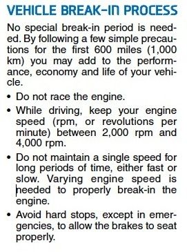

Here is the break-in information from the manual
As you put miles on your new Genesis you will also notice the exhaust note will change around 2000 miles. Drive it like you stole it after the break in. You will also notice poorer fuel mileage during the break-in period. It improves over time. On average I get around 21 mpg with my 5.0 in mixed city/highway driving. Not bad for a car with 420 hp. I burn Mobil Super Unleaded now full time. Worth the few extra penny's per gallon and on average improved the fuel mileage to offset the cost.

Pretty funny. They say that NO break-in period is required, but then they go on to describe one.
