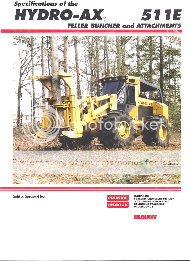

In another life, I was the chief engineer for a company that made logging equipment. Our engines came from Cat, Cummins, Detroit Diesel, and Deere. A diesel engine has a surplus of air for its rated hp (partly due to emission standards). Adding more air to these engines would have had little or no affect on hp or efficiency. Indeed, the surplus of air can be demonstrated by modifying the injection pump to inject more fuel. Even on naturally aspirated diesels (rare these days), some gain in hp is usually observed.
While the 5.0 is direct injected like modern diesels, it still needs a spark plug to fire. The compression ratio is not enough to fire the combustion.
Being direct injected doesn't change the integration of the fuel system with the air intake system and its various sensors. Only the fuel that can be efficiently burned for the conditions of air temp, mass air flow, and engine temp is injected. At WOT, some of the efficiency may be sacrificed for peak power, however.
By the way, the engine manufacturers, that we bought engines from, would send in an engineer to review our installation of "their" engine before production engines would be shipped to us. They would have laughed themselves silly if we had proposed an oil wetted air filter instead a "paper" element air filter of known flow and filtering capabilities.
Here's a picture of one of our machines:
