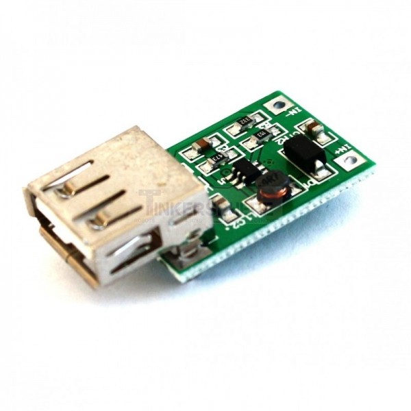

I would assume that upgrading the USB is impossible to do without removing the USB module since the USB circuitry is part of the head unit itself. Therefore , it is possible if you know your way around a soldiering iron and circuity.
You will need something like this that can be swapped in place of the .5 amp USB charging circuit.
