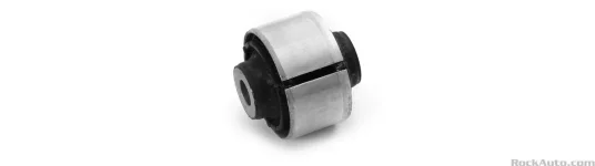

My mechanic is quouting $5k+ total cost to replace front control arms cause my car was swaying right to left at speed (the bushings are bad) $2700+ just to swap out bushings. Where are you getting parts?
Your mechanic should demonstrate to you which bushings are bad and provide a video of them so you can show other interested parties how bad they must be. Members of this forum can be most helpful when they have more information about your location, your vehicle mileage, condition and specifications. A second opinion could be your best alternative.
OEM / Interchange Numbers: 54584B1200
OEM / Interchange Numbers: 545513N500
OEM / Interchange Numbers: 54501B1000
