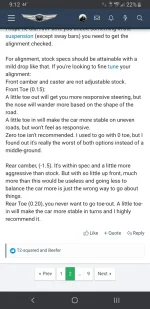

I have read about some suggested alignment settings for our cars. See attached.
