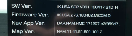

Currently running these versions. Anyone with a G70 seeing anything different? I am having the call taken in for scheduled maintenance this week and may ask them to make updates if there are any.

yeah that is software release 12, (http://www.mapnsoft.com/media/manual/v12/New Map Features Hyundai America Gen 4.pdf)
same version I had with the issue. Version 13 is out now, carplay was fixed with my version 12.5 and I updated to 13 today.
dealer might not be able to upgrade it, you might have to order it (it is free for 3 years to new owners) from the mapnsoft site, there are like 4 threads about it here explaining how to get the update.
