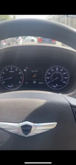

Yeah... Sometimes my lunch bag will trigger it. I just fastened the seat belt...
This pops up on the dash with an empty seat.

You may need your fuel control module replaced. I was getting the same warning popping up randomly (along with throttle response issues / outside temperature display disappearing). Apparently it's connected to quite a few things. It's a fairly cheap part online (~$50), though mine was covered under warranty and dealer had it replaced same day.
If you have an OBD2 reader, checking for error codes may help diagnose further:
