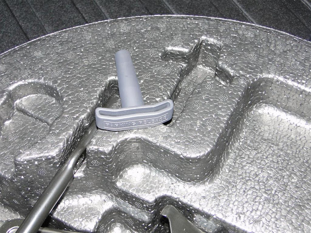

BYW, does anyone know what the Parking Release tool is for and when to use it? I found it in my trunk.

If your electronic parking brake gets stuck. Page 5/23 on the new manual....
EPB emergency release
If the EPB does not release properly, do
as follows:
1. Shift the shift lever into P (Park).
2. Block the wheels.
3. Open the trunk and remove the cover.
4. Remove the emergency release handle
from the tool case.
5. Remove the emergency release cable
cover.
6. Install the emergency release handle
into the threaded end of the emergency
release cable by turning it clockwise.
7. Pull up the handle until sounds a
"took".
The EPB warning light blinks.
8. After using the EPB emergency
release, a warning message will come
on.You should operate the EPB switch
for the vehicle to return to its normal
condition. If the vehicle does not return
to normal condition, take your vehicle
to an authorized HYUNDAI dealer and
have the system checked.
