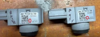

I removed and cleaned both of the center sensors. Connections looked good and put some dialectic grease on the connectors. Part numbers for these sensors were the same, but the QR code showed a minor difference in the part number.
QR Code part numbers
Driver\Left - 95270-B1700--20170421-07127960
Passenger\Right - 95270-B1700--20170421-07127940
I speculate the difference in the last two digits is mfg. date or a revision, but these 2 sensors appear to be interchangeable as replacement for either center parking sensor. The outside sensors ARE a different part/number!

I took out all 4 sensors, cleaned up and added dialectic grease to connector. Picture below is driver side on left and passenger on right. The inner sensors had removable mounting brackets (shown at top of picture). The outside sensors brackets were not removable.
