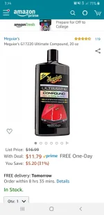

Before letting the dealership replace, try using some polishing compound if you haven't already. This is what I use.
I don't know about the wisdom of using compound on chromed plastic trim, it seems like it might get micro-scratched to hell that way.
If I had to theorize, I'd guess that maybe it's whatever substance they use to stain the trim darker is causing that issue.
EDIT: But I guess if its getting replaced anyway you might as well go to town on it and see if it works.
I didn't try the polish, but I did try some compound, alcohol, paint thinner...none of which worked. I would like to try some acetone, but afraid of getting on the paint
Definitely stay away from all of the harsh solvents. Not worth the risk of accidentally damaging your clear coat.
