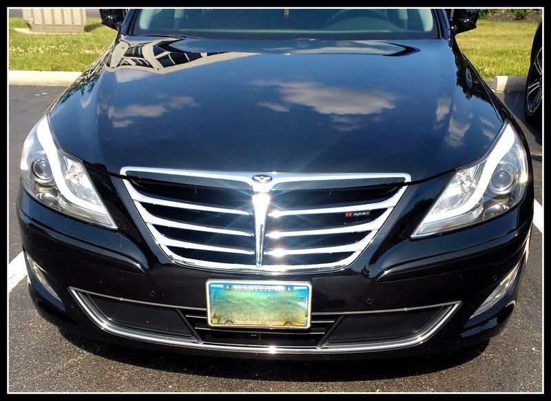

I have a 12 Rspec and I just had all my chrome trim covered with gloss black vinyl and it looks so much more aggressive!
Please post pictures!
Did you do every single bit of chrome?
Including the grill? I'm a little hazy on how vinyl wrap can be applied to such complex geometry...

I didn't have the door handles, the edges of the grill or the window trim covered. Just the trim on the sides, bumpers and trunk.

Unevakno: Wow, your car looks tough! Love it! Odd--I don't have a winged badge on the hood portion of my grill--and did you take the rear R-spec badge & stick it on the grill? My grill doesn't have that either. (Mine's a 2012 R-spec.)

Jason, Thank you for the positive comments. I have since then removed the badges from the grill but the car has always had the original R spec badge on the trunk. I purchased 2 more and had them clear coated to protect the finish.

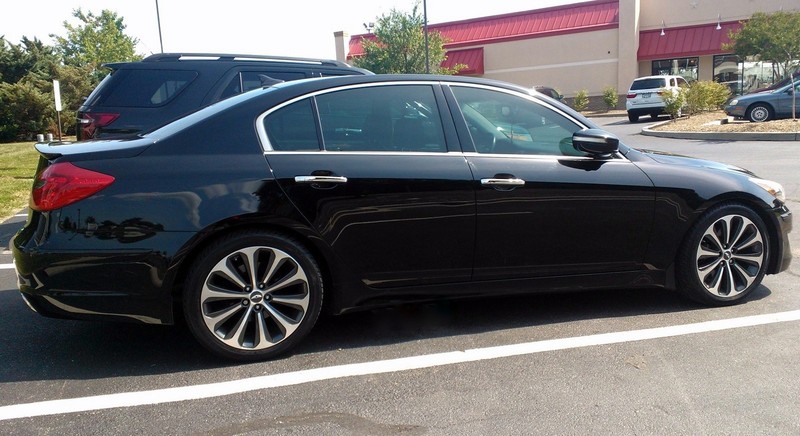

So, I FINALLY posted a picture of my 2011 after Jason and I swapped Chrome / Black trims. While Jason went all black, I seem to be going more chrome, with my 19" wheels and now the Chrome Trim. ( I also tinted the car 20%)
Jason did a spectacular job in fixing the chrome trim's clips that broke when he removed it from his car. We both discovered the chrome trim is much less forgiving than the black (flexible) trim.
Anyway, here's a pic of my car with the new chrome trim. Jason and my swap worked out great!! And we both got what we wanted, and only paid shipping.
If anyone else tries it, it's a good swap!!
Jerry
