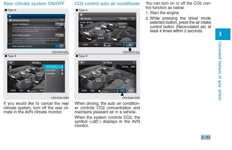

Do what I did. Turn it off. You can control it from the front. See below. 95% of the time I have no one in the back seat so this function works best for me. When some one hops in the back seat, you can quickly re-activate it so they can control the air themselves. You can activate this feature by pressing the "Climate" button locate on your dash.

Has anyone tried turning on/off co2 control? I tried quite a few times just to see if it does turn on/off following the instruction but haven't seen any difference or indicator changes.

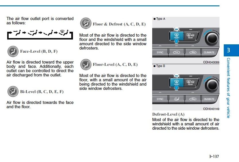

If you change the directional flow of the system to down only, you get a warm flow..but this disengages Auto mode. It seems (I'm not sure about this) that what this change accomplishes is not to cut off the cold air, but to mix warmer air with the (still flowing) cold air.

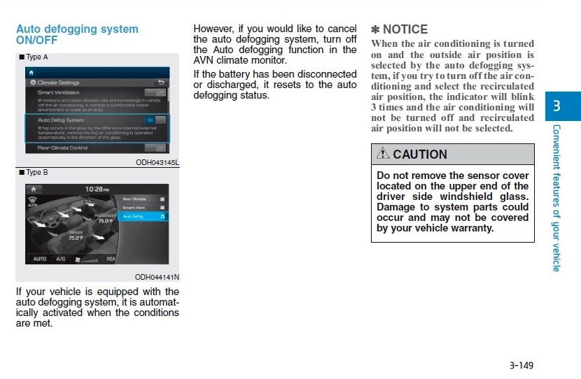

Have you tried turning off the Auto Defogging feature to see if that is the culprit? It might be redirecting the hotter air to the windshield not allowing it to heat your feet as much. Just a thought. It can be turned off by pressing the "Climate" button and un-checking the "Auto Defog" feature.

Keep us posted. I will try the method noted above in the morning and report back. I played with the heater on the way to the store this afternoon and it seemed to work ok. You must look at the nav screen to figure out which direction you have the flow going. It cycles thru Feet, Feet Window, Cabin etc...

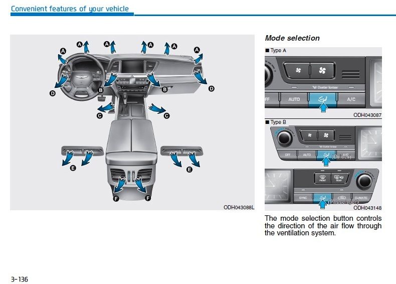

When you press the mode selector button (I have Type B shown below)...
...you will see these options show up across the top bar of the NAV screen.
Let me know if you any more info. It is 40 degrees out this morning here in South Florida. Will be heading to the store in a couple of hours and will turn off the Auto Defog feature to see if this helps with the heat on the feat issue. I will report back later this morning.
To turn off the Auto Defog setting, press the "Climate" button and un-check "Auto Defog"...
