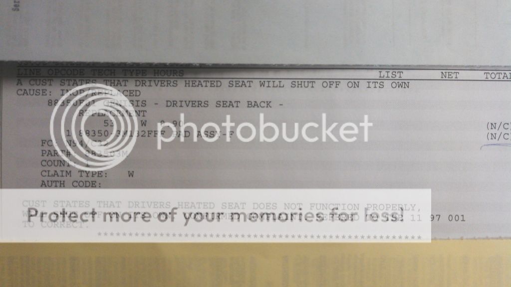

I had the exact same issue as you and I think they either fixed mine the first or second time I brought it in but it wasn't much hassle. I'll try and remember to look up my service records to see if they indicated a specific problem on mine. But all I did was describe the issue and they got the parts and fixed it. I believe the parts were only like 200 bucks so its not a huge warranty claim for them.
Thanks mitch, any information that I can bring to the dealer would help !
So far my local dealer has been great but I don't want to piss him off
Here you go, seems it was a TSB
Should be all you need for sure
I think that's the number on the picture...
11 97 001
