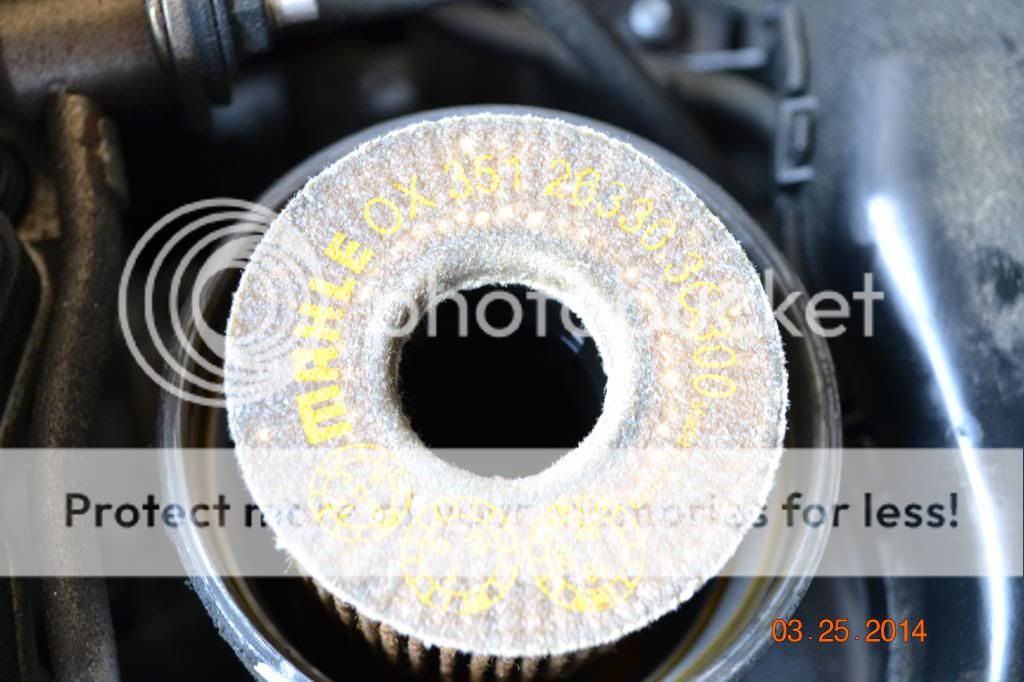

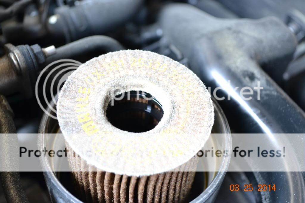

I would be interested in seeing exactly what kind of oil filter your dealer uses. Can you unscrew the filter cap and post a pic (don't have to remove the filter). You will need a 27mm socket to remove the plastic filter cap.
Also, I would consider using 5W-30 synthetic. 5W-20 may be too thin, and you should not have cold start issues with a 5W-30 synthetic.
Mark its a white mahle filter. I can upload a picture later when my wife is off the computer.
filter photos
