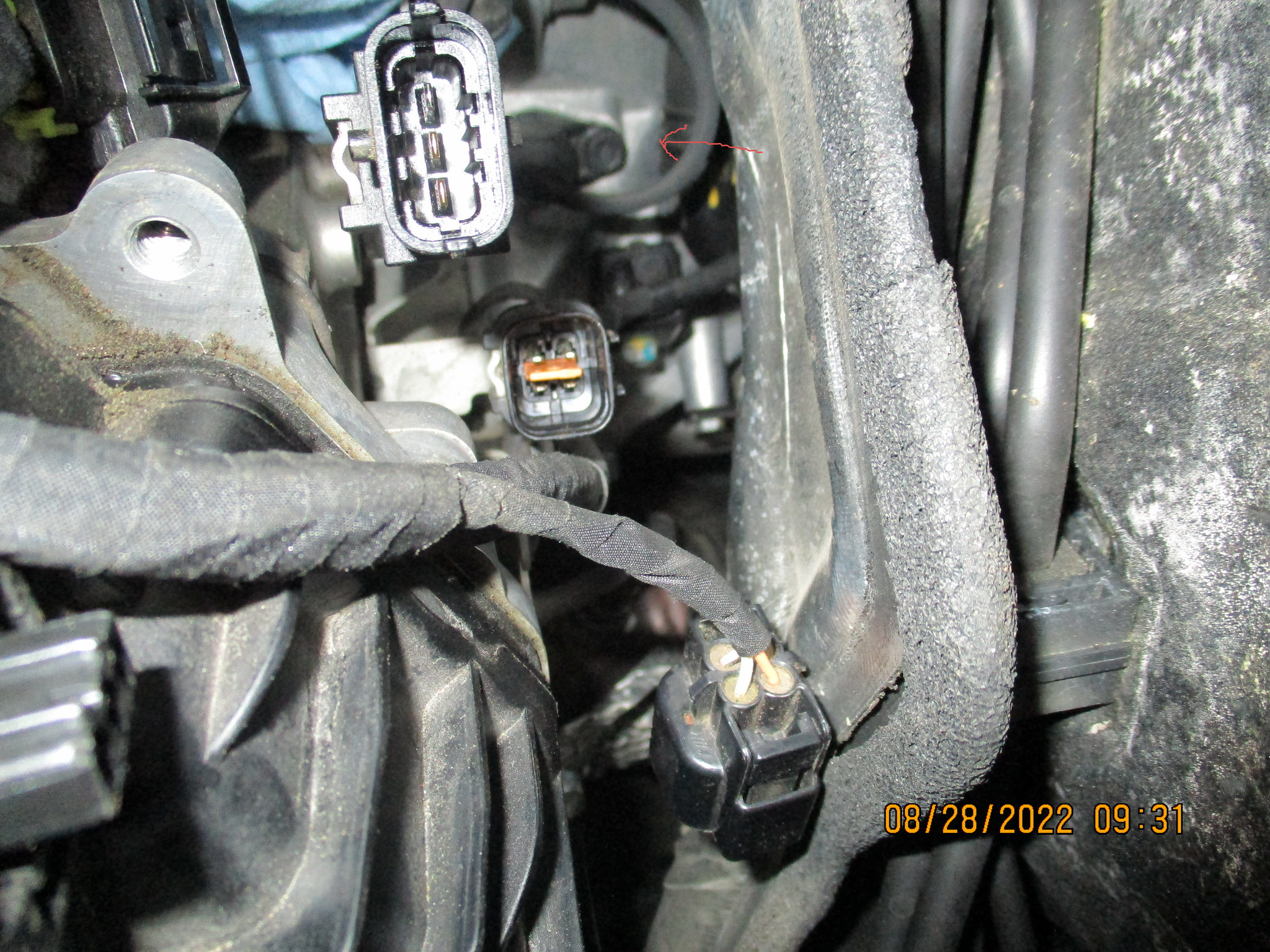

It is located under the driver side valve cover near the firewall on the bellhousing. Number (6) in diagram
You can actually see the crank sensor under the camshaft sensor(A) on the bell housing in this pic.
Here is the crank sensor on my 5.0 engine.

It is a 2015 5.0 Genesis model. The pic is looking down from the engine bay from up top. I believe you will have reach down remove the crank sensor from above. However, it could also be reach from the bottom maybe. I did not remove my crank sensor; only my camshaft sensors.

No problem. I probably should replace my crank sensor as well while I got the chance since it does require removing a lot of crap to get to it.
