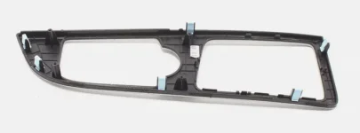

1) Use plastic pry tool to pop out the shifter bezel. I just went down the right side and it all popped out. Disconnect the wiring, it's a simple press tab.
