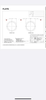

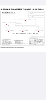

Hi i am new here but i will keep it short. I wanted to get my engine bored to a 5.0+ *cant get over the speed of my old 12 5.0 rspec, but basically the cnc machining guy said the cylinder walls would be too thin and he couldnt do it. I contacted Darton sleeves and they will build me custom sleeves in order to overbore. I just need help filling out this sheet because i have no idea about this kind of stuff. I basically want my engine overbored to atleast a 5.0. The sheet is attached below, please help

i know it wouldnt give the same power but its a huge step, the 5.0 is direct injection has bigger throttle bottle etc but boring will give the 4.6 a huge boost in torque. The 4.6 and 5.0 use the same exact exhaust systems, the 5.0 is a bored out version of the 4.6. I just need that sheet filled out to sleeve my engine
I understand. I'm sorry I can't help with the sheet as it's well out of my expertise with this motor, but maybe an independent shop that works on Hyundai could help? Have any local shops around you that would fit that profile? They might be able to give you the info to fill it out. Shot in the dark, but worth a try.
Just curious as to why someone at DARTON CUSTOM SLEEVES wouldn't be able to help you fill it out?
