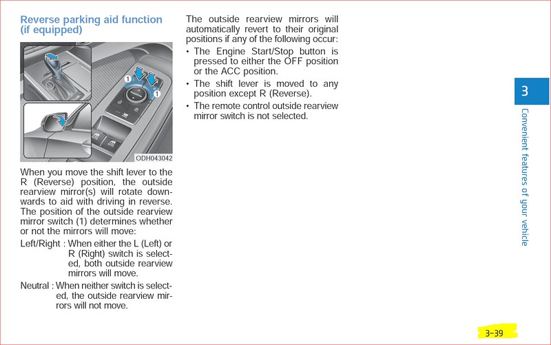

Hello Gang,
My one month old 2016 3.8 Ultimate's door mounted mirrors just stopped tilting down when the transmission is placed in Reverse. Is there a setting someplace to reset this?

Check the position of the mirror toggle switch. If it's in the middle it will not tilt
Note that "in the middle" means neither 'L' or 'R' is selected. You can toggle these off or on by pressing again. If neither is selected, the mirrors will not tilt (which I like to leave unless I need them to tilt for when I am near a curb, etc..)

They've already answered your question correctly . BTW - it's clearly detailed on page 3-39 of the manual (though no one seems to check that anymore)...

Ray -
yes we understand. We are not referring to the forward most switch. You are correct that switch controls the folding. We are pointing you to the actual L and R buttons. When neither L or R is selected, the tilt down is disabled. When EITHER L or R IS selected, the mirror will tilt down in revers. Press "L", and the LED indicator should light. When LIT, put your car in reverse, and the mirrors will tilt down. To disable, press "L" again, and the LED indicator will go off, and the tilt is disabled. Try it and let us know how it goes.

This ^^^^^ works every time.

Great. I'm having difficulty learning Hyundai logic. I thought we had checked the user manual. Thanks everyone that answered.

Hmmm... The reverse aid mirror function (mirrors tilting down) is on page 3-39 in my 2016 manual (USA) - 3-38 is the mirror folding function.

Interesting. I used the downloaded pdf user manual. It actually does not state if it is 2015 or 2016 but the copyright is 2014. It would not surprise me if the 2015 pdf is loaded in the 2016 myhundai.com site for download.

I have a 2009 Hyundai Genesis this is not in the manual from my version of the car and I Have all the books that came with it. BUT it is the same was if you move it left then the mirrors both go down in reverse, if you put it in the middle neither one does, if you put the switch to the right only the right mirror goes down.
