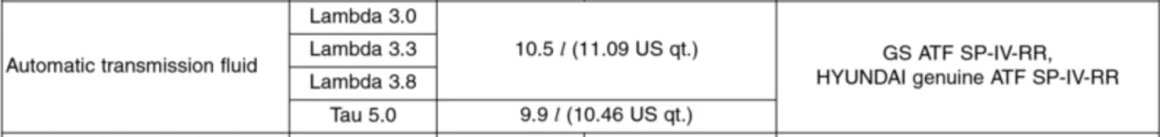

I would only do a Drain/Fill. You'll get < 3qts exchanged each drain/fill of the 10.5-11qts in the pan. If you drop the pan, you'll get almost 7qts drained.
