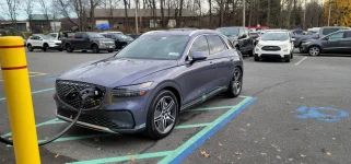

I thought I'd share a few pictures from my first experience with DC charging. Typically, I charge my vehicle at home 100 percent of the time. However, we recently took a trip to Poughkeepsie, NY for my daughter's college open house, and I decided to give DC charging a try.
Resized GV70 Charging 1.webpResized GV70 Charging 2.webpResized GV70 Charging 3.webp
Cool, I hope it was seamless... What charging speed did you get?
The process was quite seamless overall, and I had to use my CCS to NASC adapter. Despite this, I was only able to achieve a maximum speed of 88 kWh, which seemed lower than expected given that it was a 240-kW station.
Indeed, hard to say if the station or adapter is at fault here...

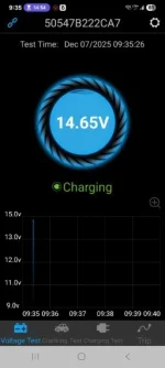

Further to my previous post on the topic (ref. above), I received the NOCO Genius10 Smart Charger a couple of days ago and right away connected it to my eGV70's 12V system at the POS and NEG jump start connection points under the hood. I left the charger connected for a straight 36+ hours. I have a BM2 Battery Monitor device connected directly to my 12V AGM battery. The device sends battery voltage data to the Battery Monitor app on my smartphone via Bluetooth. I can view my 12V battery voltage info in real time as well as call up charts in the app that show battery voltage values throughout the period(s) of 1 day, 7 days and 15 days.
It was interesting to study the 1 day chart 24 hours after the Smart Charger was initially connected. The charging voltage (as measured at the battery) varied quite a lot during that period - sometimes as high as 14.8V and sometimes as low as 13.4V - and still other times where the voltage was somewhere between those two extremes. When the Smart Charger indicated charging was complete, the voltage on my 12V battery showed 12.9V after I let the battery "settle" for a while. That's a great (perfect) voltage for a 12V AGM battery and indicates a proper full charge.
On the chart I looked at that covered the hours after the initial full charge, the Smart Charger carried out further "mini" charge sessions (of about 10 minutes in duration each) about every two hours or so. Interesting!
I drove my eGV70 to a number of places around town today (shutting the car off several times) and never once did I see the orange 12V charging indicator light come on. It's still early days but I believe the new Smart Charger has helped revive/restore my 12V AGM battery. :) I will continue to connect the Smart Charger to the car every night for the next few weeks - it certainly can't hurt.
P.S. I looked at my Battery Monitor phone app a few times today with the car ON/running and consistently saw 14.65V on the screen. And whenever I use the Level 2 charger (EVSE) in my garage to charge my eGV70's main battery, I have also only ever seen 14.65V on the phone screen. So... unlike the NOCO "Smart Charger" that applies numerous voltages and strategies/routines to achieve its charging goal, it appears the eGV70 utilizes a "Dumb Charger" (a singular voltage only) all the time to charge the 12V AGM battery. Well hell.. that's interesting too!

Well Hooray! Good work and perseverance. Plus buying the charger paid for itself 2x over on its first-aid first use, and you have a permanent backup and an on-vacation solution too. Well done!
