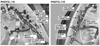

There are many grounds. There is no single list AFAIK. But here are several ground locations from my 2009 manual (the ones that begin with "G"):
